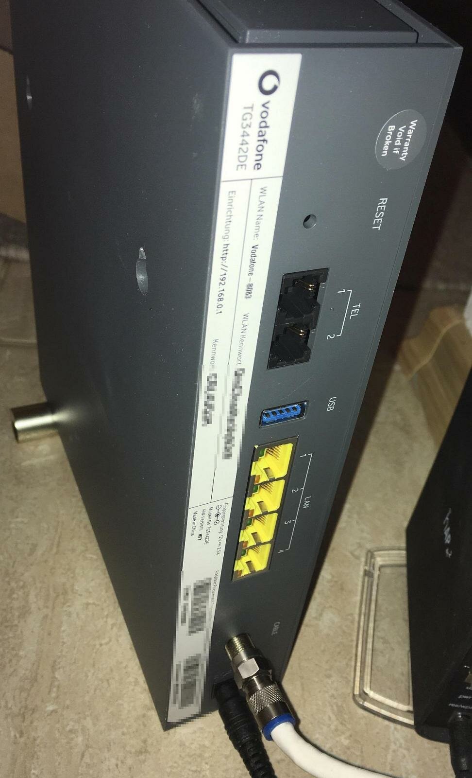

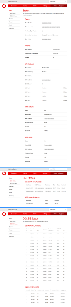

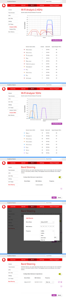

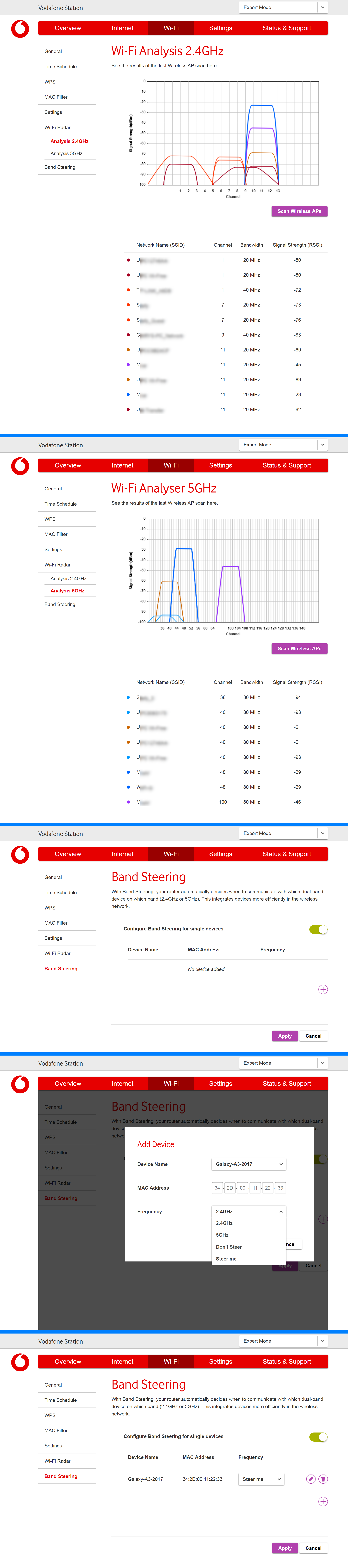

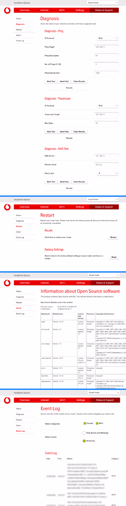

Hi everyone. I just read (with help of Google Translate) the posts here. I saw that main subject is about the router who will be deployed in Czech Republic after UPC CZ was bought by Vodafone.
Romania was bought too by Vodafone. So they already started to test a modem - Arris_VodafoneStation_TG3442DE. This type of modem was deployed to some employees. The employees test the modem for DOCSIS 3.0, as DOCSIS 3.1 wasn't started yet due to analogue channels that are still on lower frequencies (118mhz-240 mhz), and as you may know, upstream channels run only till 200 mhz. In capital city of RO (Bucharest), they started to announce that channels between 118 mhz and 140 will be moved on 18th of May.

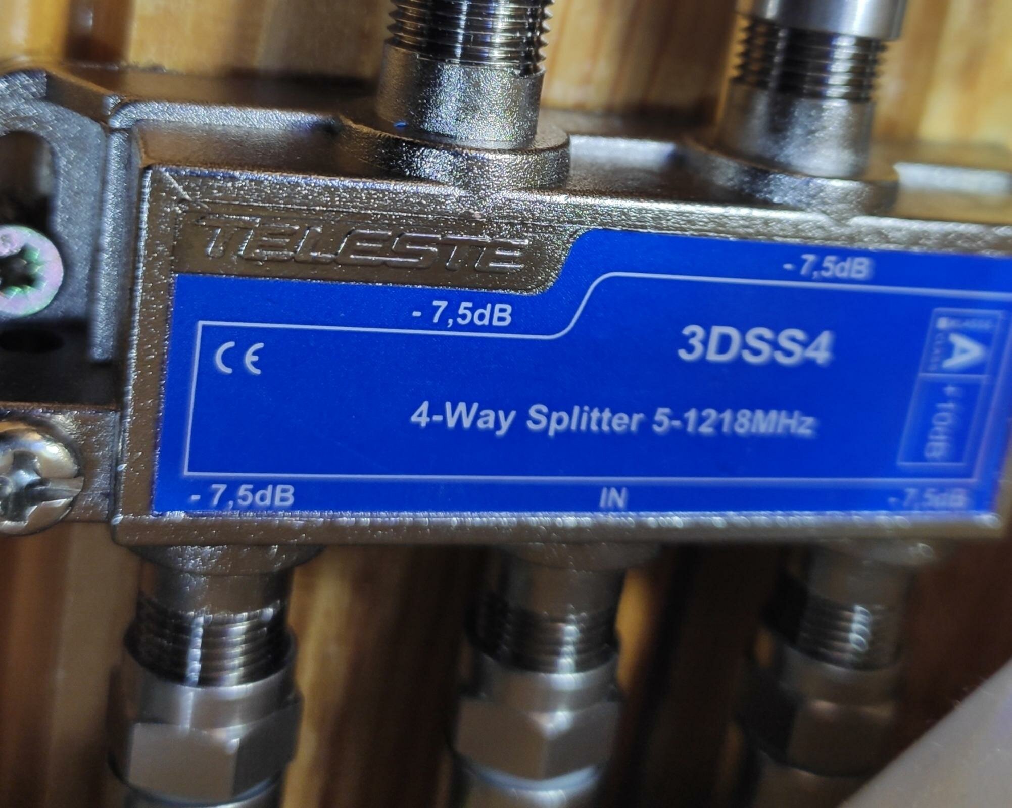

Also maybe you may know, but the splitters need to be changed for Docsis 3.1, as downstream works after 800 mhz till 1.2 ghz, and most of the splitters are till 852. (I attached a photo with a good splitter)

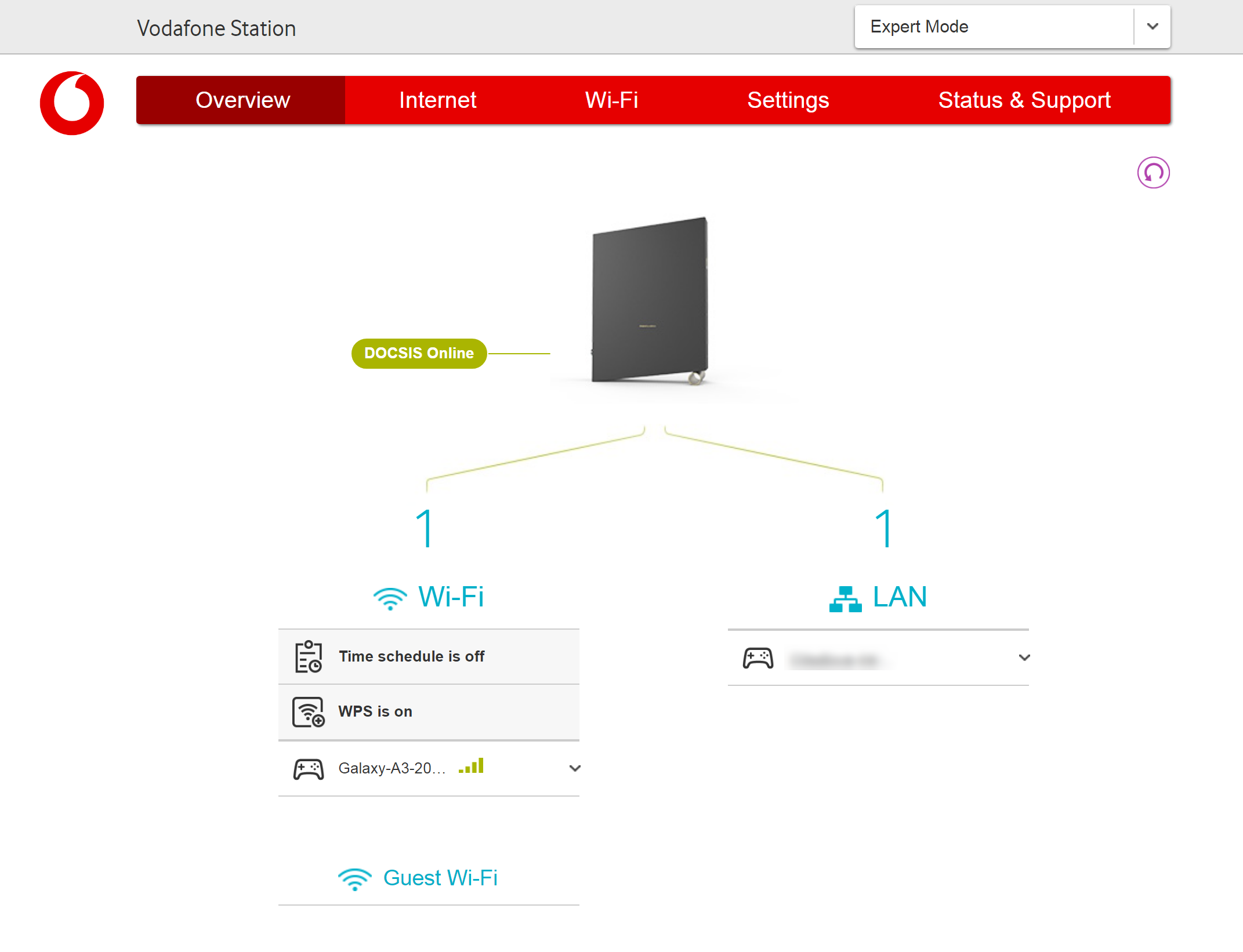

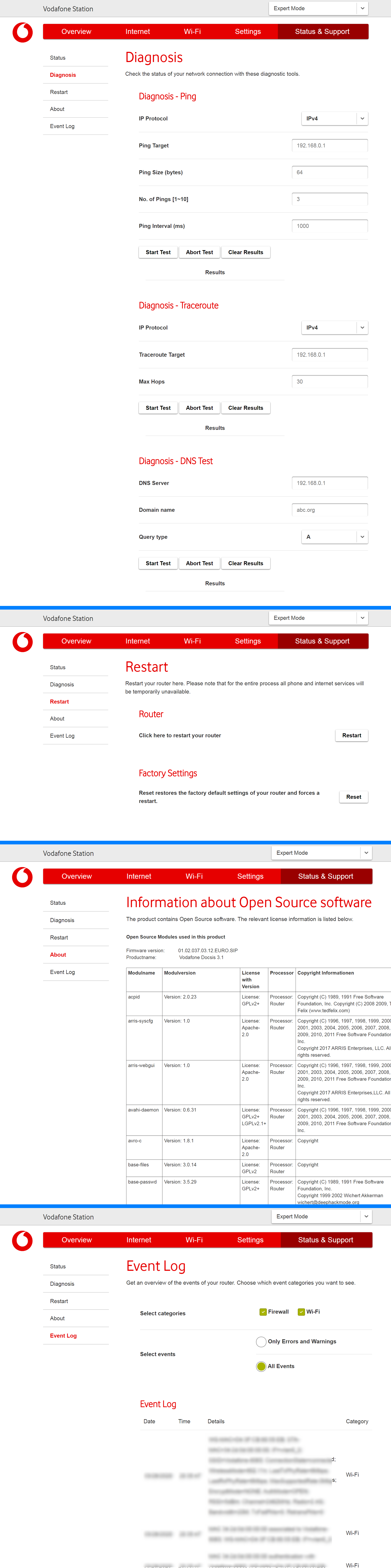

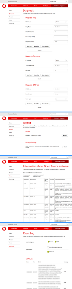

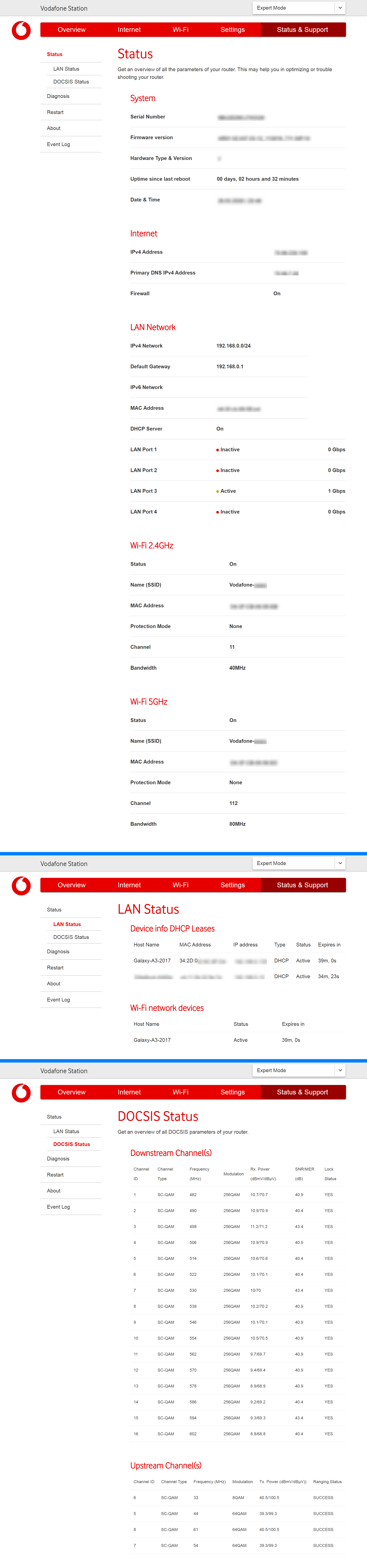

I attached some actual pics from one of the employeers.

There's no need to replace splitters - as the DOCSIS 3.1 download channel runs here in 790-850 MHz range, but for your information - german Vodafone East (ex Kabel Deutschland) runs DOCSIS 3.1 channel in 118-220 MHz range, Vodafone West (ex Unitymedia) runs DOCSIS 3.1 download channel in 770-850 MHz range, nobody uses frequency above 860 MHz.

Rozbočovače s rozsahem do 1200 MHz, už nějakou dobu instaluje i české UPC v rámci přípravy na DOCSIS 3.1
