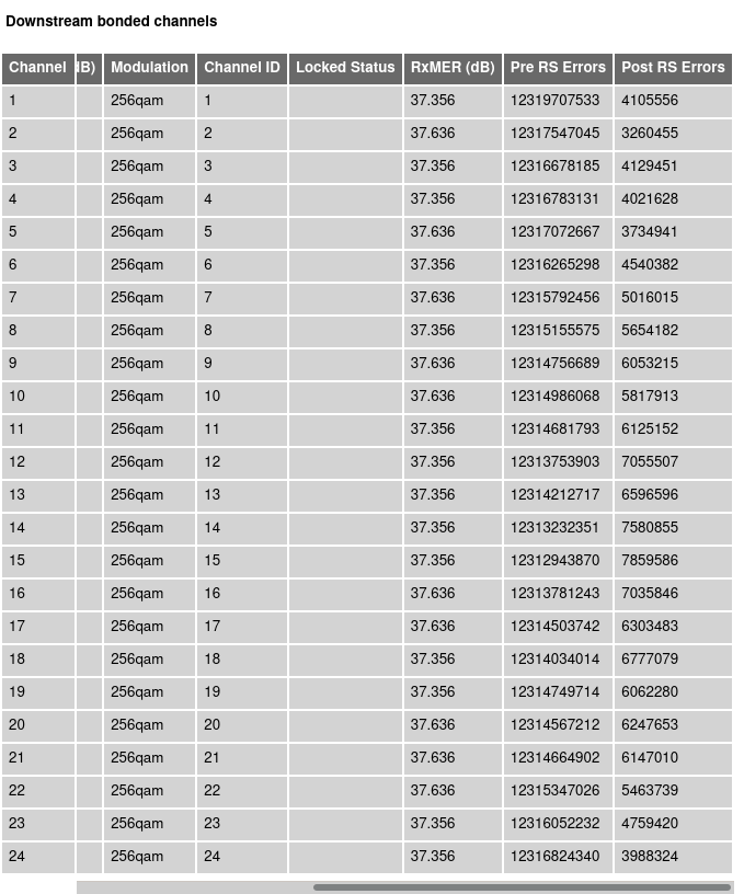

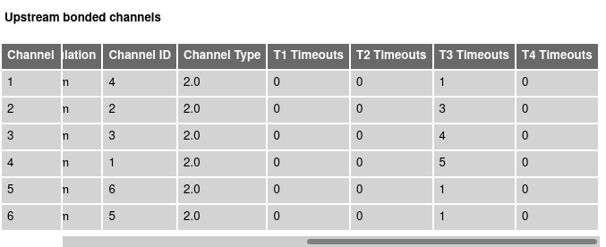

The modem is now on for aproximately 3 days and from the Dowstream Status, I'm afraid the number of Post RS Errors seems higher than the usual in all the channels. On Upstream status, there are some T3 Timeouts too.
Please, does anyone know whether these failure rates are expected? Any suggestion on how to proceed?
On the downstream there is really a very high error rate of packets, contact the customer line, they must see this problem there as well, the technician will probably have to come again and check the route properly.
Ah alright, thanks for looking into that, @tomusI'll contact the support again and reinforce that issue then.

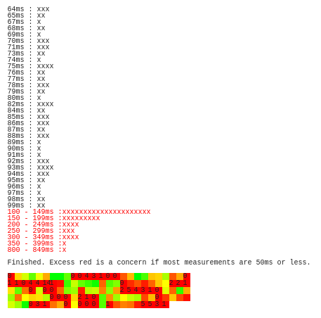

Just came accross https://www.badmodems.com/
The modem I'm using (CH7465VF) is not listed among the affected ones (https://badmodems.com/Forum/app.php/badmodems), although the list does contain other Compal models, such as CH7465-LG. Also, it does report not so good results with http://www.dslreports.com/tools/puma6

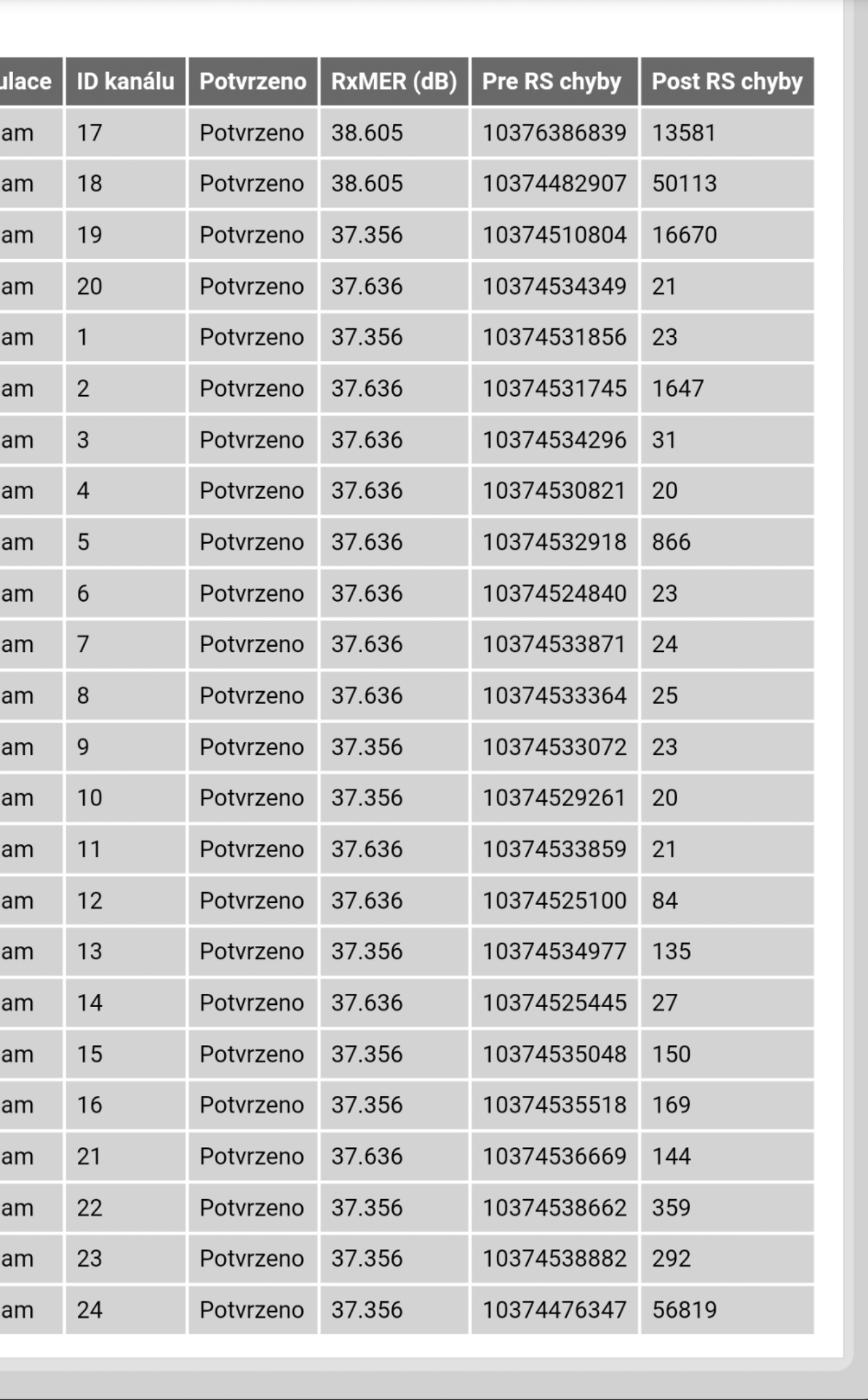

As i said the problem will probably be in the wrong signal, for a comparison see what it looks like on my modem and you watch the Post RS errors (chyby) box.
